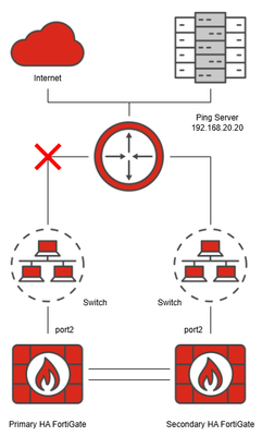

By being able to detect failures in network equipment not connected directly to the cluster, remote IP monitoring can be useful in a number of ways depending on your network configuration. In the simplified example topology shown in Figure 1, the switch connected directly to the primary unit is operating normally but the link on the other side of the switch has failed. As a result of the failure, traffic can no longer connect between the primary unit and the Internet.
To detect this failure it is possible to create a remote IP monitoring configuration consisting of a ping server on port2 of the cluster. The primary unit tests connectivity to 192.168.20.20. If the ping server cannot connect to 192.268.20.20 the cluster to fails over and the subordinate unit becomes the new primary unit. The remote HA monitoring ping server on the new primary unit can connect to 192.168.20.20. As well, the new primary unit can connect to the Internet; so the failover maintains connectivity between the internal network and the Internet through the cluster.
Figure 1: Example HA remote IP monitoring topology
